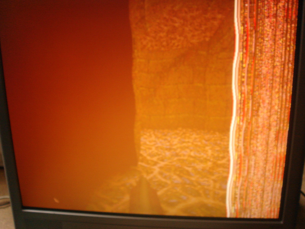

Tak, na szybko: TimeDemo1 na chwilę obecną - 19 FPS. Postaram się za niedługo wrzucić jakieś filmy
Could you try my new version 1.13 of Quake from PXL Computer, should be faster ?
I found a little subroutine (_ldexp) used a lot in the 3D rendering...
==> http://cosmosamiga.free.fr/QuakePXL_113.lha
Important : you must install the 68060 mathieeedoubtrans.library into your Sys:Libs/ directory
==> http://www.hsmathlibs.de/HSML_public/HSML-V46_00-060-demo.lha

I've just tested it and here are the current results:
TimeDemo demo1:
Previous version (1.00/060) : 18.42 FPS
QuakePXL_113 : 17.61 FPS
-0.81 FPS
So a little bit slower. I have 060 math libraries installed.
Both test were made with 68040/060 copy routine selected.
[#593] Re: A500 Turbo ..... inaczej
@Sellen, post #592
Oh, I started my versions with the 020 on the original CD, because sadly the 060 version have some heavy gfx glitchs under water with resolutions more than 320x200 or 320x256 (AGA or RTG). Checked on Apollo, Blizzard cards and WinUAE...
The 020 version is ok, no glitchs under water...
Don't know where exactly are the bugs, I tried different 68060.library...
But yes, the 060 version is faster than the 020...
Still more works must be done by me to speedup this game...
Ostatnia aktualizacja: 16.03.2019 14:11:32 przez CosmosAmiga
[#594] Re: A500 Turbo ..... inaczej
@CosmosAmiga, post #593
It's good to hear that, beacause I actually wondered if it is some my bug in memory controller or something :D
I have the same on 060 version. Tried different resolutions, color depths, etc. The interesting thing is that sometimes it seems to working good quite a long.
I've tested 1.00(non-060) version right now and it scores 17.68 FPS, so practically the same speed.
Anyway - really great job.
By the way - some day it could be possible(theoretically) to make Quake version exclusive for Warp1260/560 cards and make some use of onboard 400MHz ARM CPU/FPU
