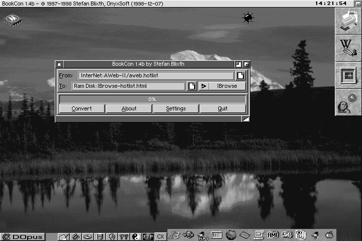

When installed properly with the provided installer script, two lines are added to the S:user-startup file. One to create the DOpus5: assign and another to add DOpus5:C/ into system search path. These don't affect how the system will work generally.
Then you are presented with four options how to install the program:
a) Install Opus 5 as Workbench Replacement
b) Start Opus 5 on boot
c) Start Opus 5 Iconified
d) Do not start Directory Opus on boot
If you choose a) the original C:LoadWB command is replaced with DOpus's own LoadWB (LoadDB) command. The original C:LoadWB command is renamed to C:LoadWB_old. If you want to boot into the original Workbench instead of DOpus as a replacement, you can just hold down the SHIFT key at boot and DOpus LoadWB will launch the LoadWB_old instead. There's no need to edit anything to revert into your original setup whenever you want!
Options b) and c) would install a small launcher file into the WBStartup drawer.
I was also sceptic about the DOpus 5.x at first, but then my friend finally persuaded me to try it. After a week I was hooked and since then I have never returned to DOpus 4 anymore. OS3.5 and 3.9 didn't offer practically anything when I was already using Magellan II at that point. Magellan II as a WB replacement was so good and packed with features you've neven seen in standard Workbench installations. Icon placement, RMB context menus, inline editing of filenames/dates/comments/protectionbits (most powerful thing ever!), versatile batch renaming, built-in FTP, startmenus, archive browsing, consistent function editor for buttons/menus/listermenus/startmenus/hotkeys/everything, global hotkeys, copying filenames to clipboard, and so much more I can't list right now.
I'm actually still using version 5.82 on my MorphOS setup more than Ambient. Here's a tutorial I wrote how to install the original Magellan II on MorphOS: https://library.morph.zone/How_to_Install_Directory_Opus_Magellan_II
